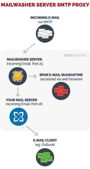

MailWasher Enterprise Server (MWES) works as a proxy, meaning it sits in front of your mail server collecting and processing all incoming mail. You will notice a significant reduction spam along with reduced load on your mail server when MWES is installed and working.
MailWasher Enterprise Server (MWES) for Windows Server. MWES may be used with any Windows Mail Server like Microsoft Exchange, SmarterMail, IMail, MailEnable and any others.
flow chart

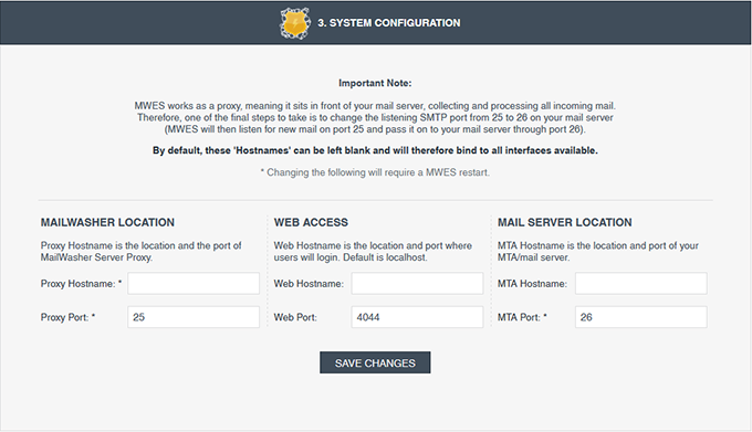

STEP ONE Change the listening SMTP port from 25 to 26 for your mail server. (MS Exchange users see the instructions above as these are different for each version of MS Exchange)
STEP TWO Run the mwes installer and follow the instructions on the screen. By default a 30 day trial period is setup on installation.
STEP THREE On completing the installation, a browser window will launch taking you to the Setup Wizard at http://localhost:4044 Click the Start Configuration Wizard button to begin setup.

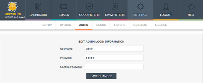

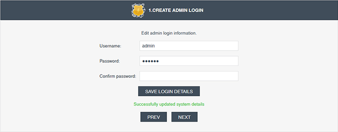

admin A. First you are asked to change your administrator password. This account will allow you to control the administration privileges. Do not give this out to users.

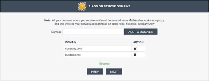

domains B. Next, enter all the domains you want to filter email through.
config C. Now, change any of the default settings if needed. Most of the time you can leave the ‘Hostname’ blank so it will bind to all interfaces available. Note: If you want to provide a daily emailed digest of blocked email to users, you’ll need to enter a domain for the Web Hostname. Users will then be able to retrieve email from http://companydomain.com:4044

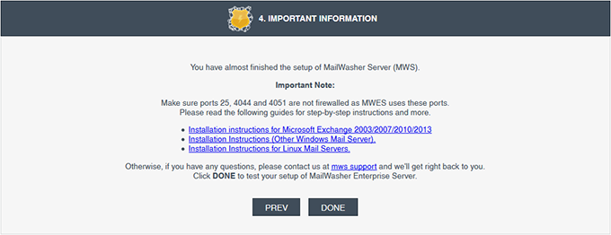

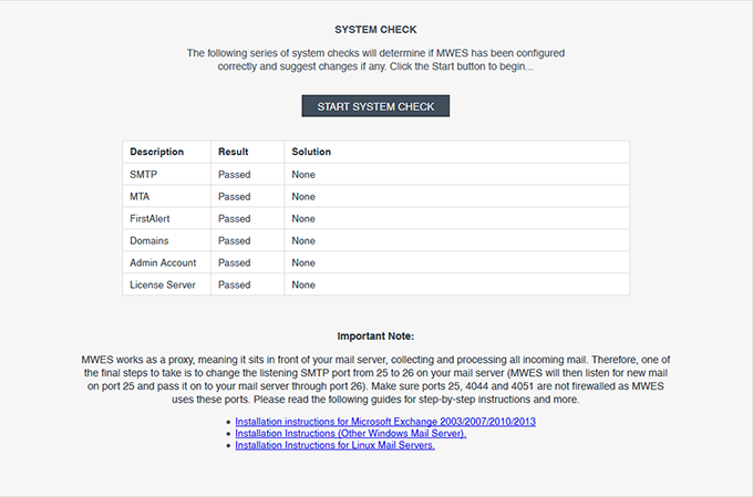

check D. Finally, you are shown the thank you screen. Press Finish to begin the System Check.

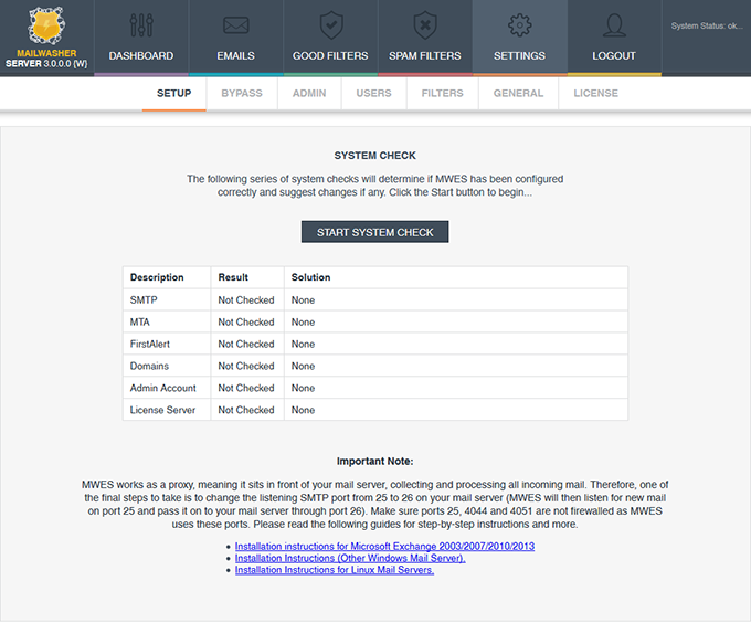

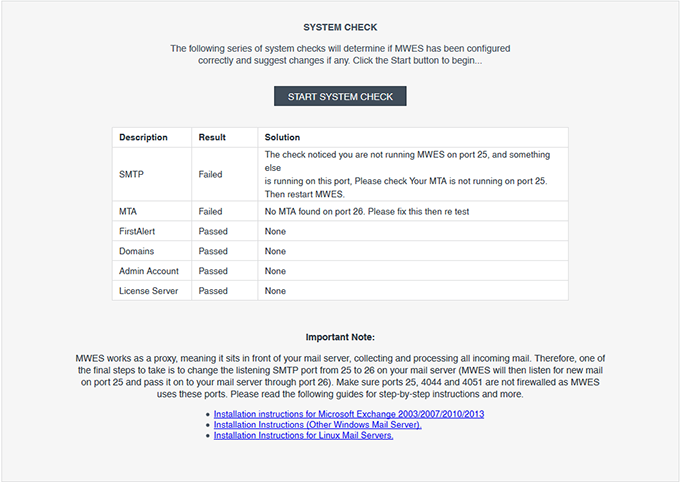

check2 E. Upon completing the wizard you will be taken to the System Check screen to ensure you have setup your system correctly to work with MailWasher Server. Press the Start system check button and MailWasher Server will run through its connectivity tests.
problem F. If there is a problem, MailWasher Server will notify you and suggest a fix. See step (4) below regarding ports or contact us at support.
passed G. If your setup is correct, MailWasher Server will notify you it has ‘Passed’ all tests.
STEP FOUR Make sure ports 25, 4044, 4051 and 80 are not firewalled as MailWasher Server uses these ports. Emails will arrive through port 25 and be checked by MailWasher Server. If email is not quarantined it will then be passed onto the mail server through port 26. Microsoft Exchange is different, see the install instructions for Microsoft Exchange.

STEP TWO Change the listening SMTP port from 25 to 26 for your mail server. (MS Exchange users see the instructions above as these are different for each version of MS Exchange)

check E. Upon completing the wizard you will be taken to the System Check screen to ensure you have setup your system correctly to work with MailWasher Server. Press the Start system check button and MailWasher Server will run through its connectivity tests.
pass G. If your setup is correct, MailWasher Server will notify you it has ‘Passed’ all tests.

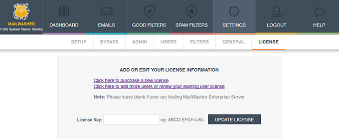

By default a 30 day trial period is enabled after installation and is extended by using a license key. Please note, you do not need to enter a license key on the trial account screen (Settings>>License) during the trial.

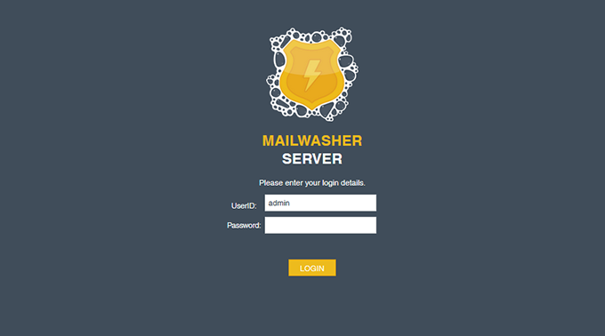

The login screen is shown after setup at http://localhost:4044 or http://[companywebsite]:4044
Login with ‘admin’ as the username and your chosen password. ‘password’ is the default password if it has not been changed.
login

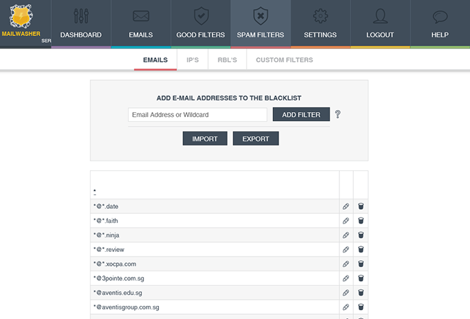

  1. You may want to add common spam domains or FROM email addresses using wildcard patterns to the blacklist. These will become apparent over time. eg domains like *@*.ninja or *@*.top or parts of emails like *@*dating.*

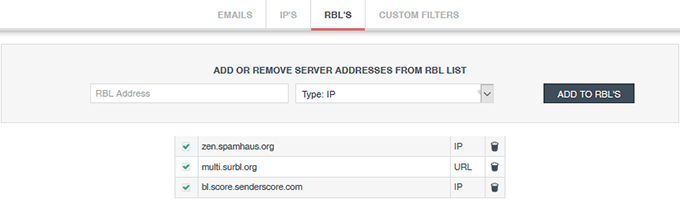

  2. Your mileage may vary but you may want to increase the RBL’s in Spam Filters --> RBLs, using any or all of these. Just be aware that this could increase false positives.
  • bl.score.senderscore.com (signup at senderscore.com)
  • b.barracudacentral.org (signup at barracudacentral.org/rbl)
  • bl.spamcop.net
  • psbl.surriel.com
  • combined.rbl.msrbl.net
  • dyna.spamrats.com
  • noptr.spamrats.com
  • cbl.abuseat.org
  • combined.njabl.org
  • dun.dnsrbl.net

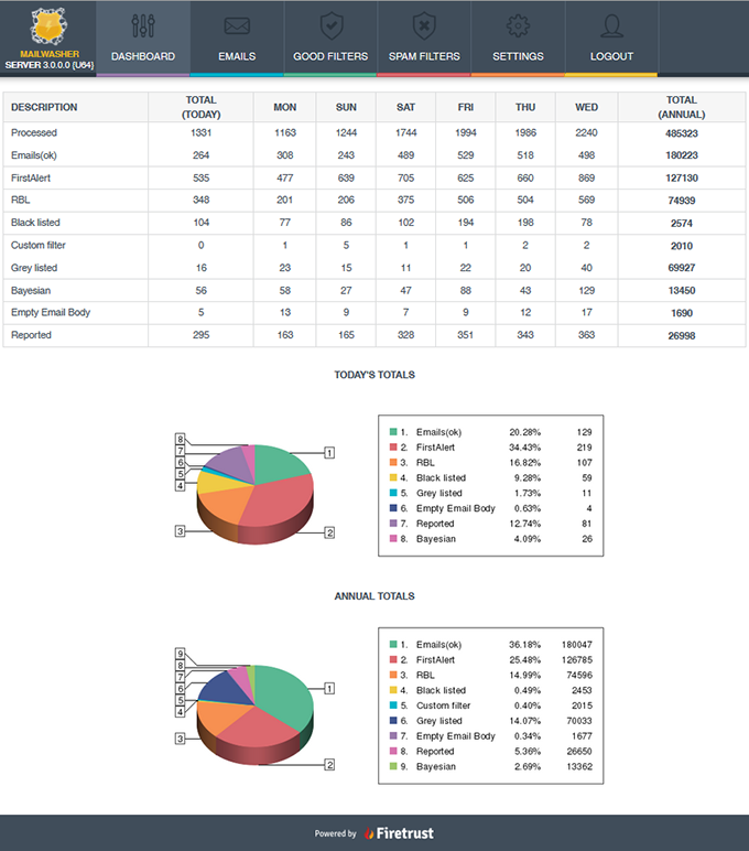

The monitor screen shows statistics of how mail is processed
  • Processed: Indicates how many emails have been processed.
  • Emails(ok): Emails which have passed through all filters except graylisting.
  • FirstAlert: Emails stopped by Firetrust’s FirstAlert signature database.
  • RBL: Emails stopped by real-time blackhole lists.
  • Blacklisted: Emails stopped by the blacklist.

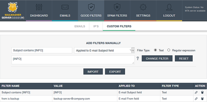

  • Custom filter: Emails stopped by custom filters.
  • Gray listed: Emails which have been gray listed.
  • Bayesian: Emails caught by the bayesian learning filters.
  • Empty Email Body: Emails stopped with an empty body.
  • Reported: Emails caught by RBL’s and greylisted older than 2 hours are uploaded to FirstAlert for analysis.

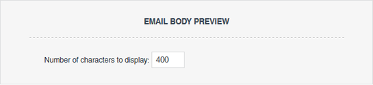

Change this to show how much of the body of an email is able to be previewed when hovering the mouse over an email in the Quarantine/All Emails areas.
email-body

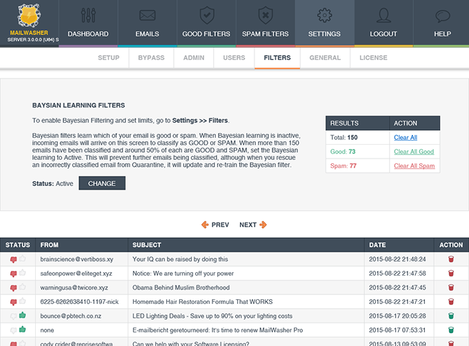

Bayesian filtering learns the difference between your good and spam email, and quickly becomes very effective at filtering spam. See Bayesian filters category below.
bayesian filtering

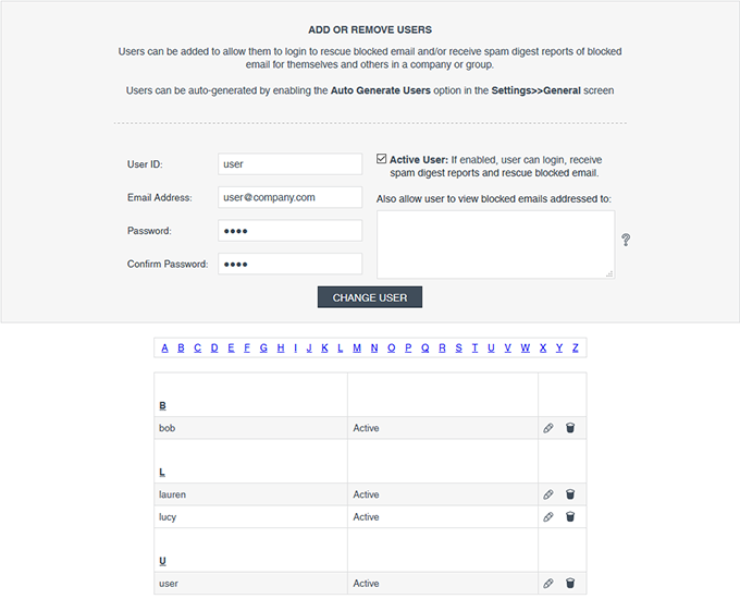

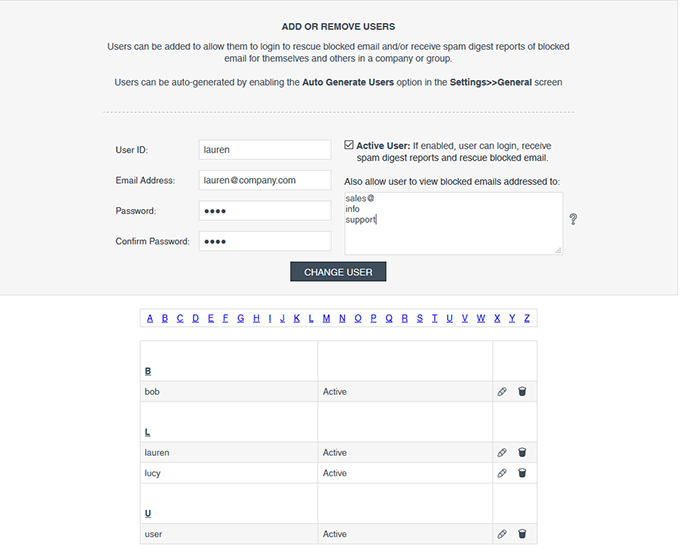

Adding users allows end-users access to the quarantine and greylisting screens via a web browser so they can view their blocked email and if necessary, rescue the blocked email so it is delivered to their inbox.
You’ll need to decide if you want to enable:
• Global Access: All users are given the same login to the quarantine area to search for their blocked email. Only the from: and subject: are visible and any rescued email is sent to the original recipient. This approach might not be desirable for privacy reasons.
• Individual Access: Each user has their own unique login to the quarantine area and they can only search for their own blocked email and any aliases which have been setup for them. Any rescued email is sent back to their inbox.
If a user account is created with a username and password, but with no email address, that account becomes a global quarantine account and all users will use that same quarantine screen to search for their blocked email. This approach might not be desirable for privacy reasons.
One global user is setup (no email addresses are entered)
NOTE: Anyone can search for their blocked email from the same Quarantine screen, search through all emails in the ‘All Email’ screen or look at and rescue delayed email in the Grey Listing screen.
global user
Individual user logins are created by creating a username and password, along with adding the users email address and a password. When a user logs in to the quarantine area they will only be able to search for blocked email addressed to themselves, and optionally any other alias/email addresses in the Also allow user to view blocked emails addressed to: area.
For an Individual User Account Login the User can view their quarantined email. Users can move their mouse over the subject line to view the body (first 200 characters by default - preview length can be changed in Settings >> General)
User setup with aliases
user login

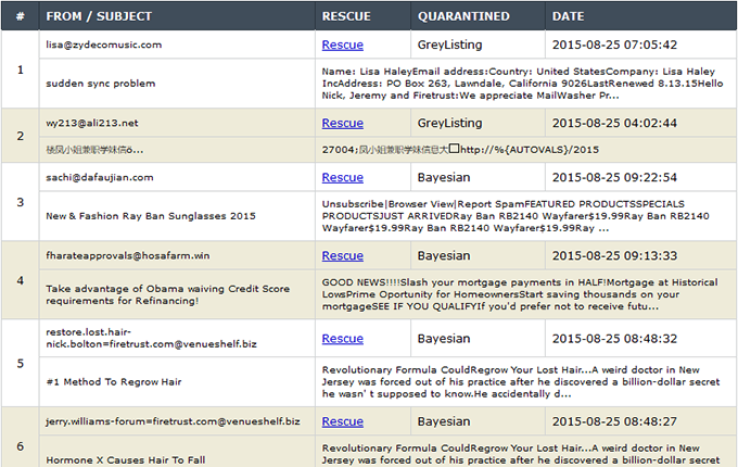

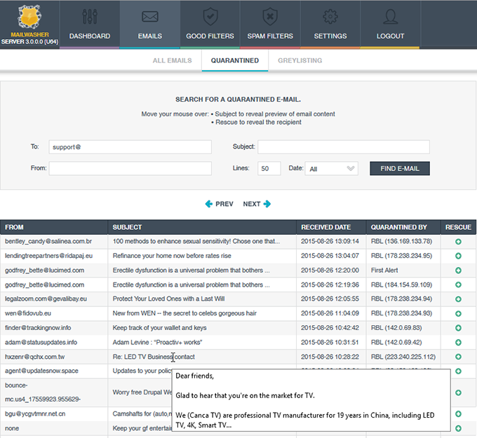

After login, you’ll be taken to the Quarantine screen where you can search for emails and if necessary, rescue them. All rescued emails are sent to the original recipient.
This quarantine screen is available to the end-users via login to a web browser so they can search for blocked email using a number of search criteria:
  • The From: field
  • The To: field
  • The Subject
  • The date
By default, when a user logs in they will see the last 50 emails which have been blocked. They can either change the number of emails to view on one page, or move through the pages by clicking the ‘Previous’ or ‘Next’ links.
You can move the mouse over the subject line to view the body (first 200 characters by default - the preview lines can be changed in Settings >> General) If a user finds an email which they want to rescue, they click the ‘rescue’ link and that email is delivered to their inbox. If the mouse hovers over the link, it will show who the rescued email will be sent to.
When an email is rescued, the senders email address is automatically added to the friendlist so it is not blocked in the future and the rescued email is delivered to the users inbox. The rescued email is shown in green in the quarantine screen for easy reference.
quarantine

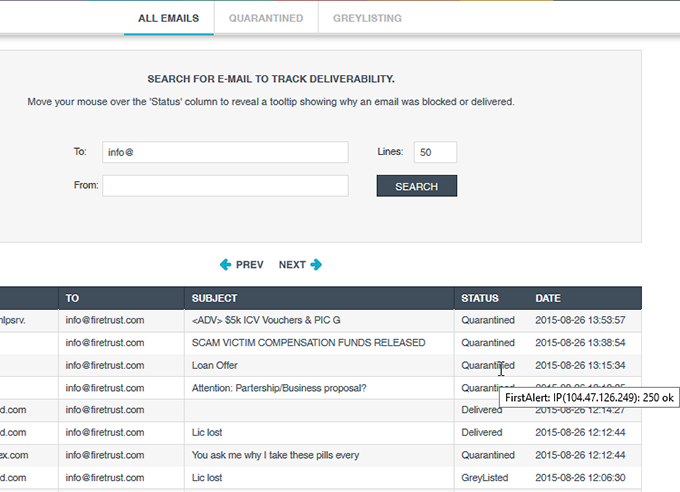

The All Emails screen shows all emails received by MWES. Users can search for an email to see if it was delivered or otherwise. Moving the mouse over the Status column items shows the reason for Quarantine, Delivery or otherwise.
all emails

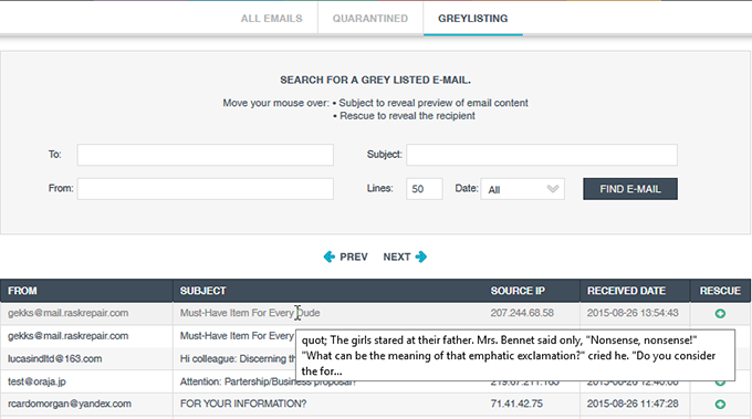

Greylisting is an effective tool to stop spam by sending a temporary fail back to the sender of the message. If the sender is sent via a valid MTA, the message is re-sent and MWES will let it through. If the message is not sent from a valid MTA it is not delivered and left in the MWES greylisting quarantine area.
Greylisting is enabled by default in Settings >> Filters >> Settings
NOTE: Valid messages can be delayed by up to 15 minutes using this method since the sending MTA has to re-send the message. You can always check the Email>>Quarantine area to see which messages are due to be resent, and thus rescue them in which case they will be added to an internal IP Whitelist. See below, the light grey message at the top is within the 15 minute time period to be re-sent. Once an email senders email has been delivered once, they are let through instantly the next time they send an email.
NOTE: Enable SPF (Settings >> General), so email is checked against SPF records and if matched successfully it bypasses greylisting.
Users can move their mouse over the subject line to view the body (first 200 characters by default - preview length can be changed in Settings>>General)
grey-listing

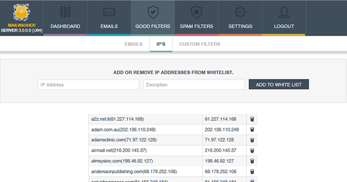

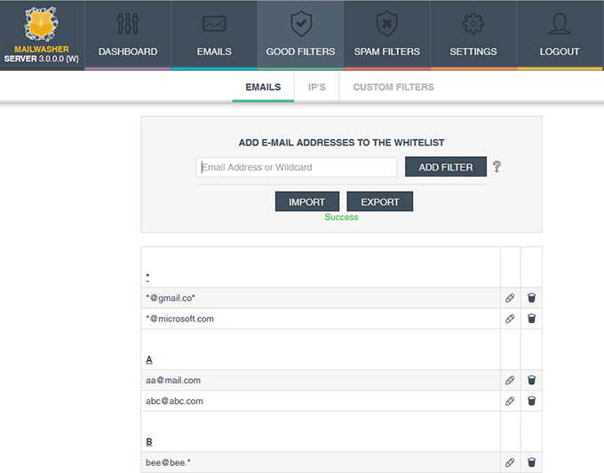

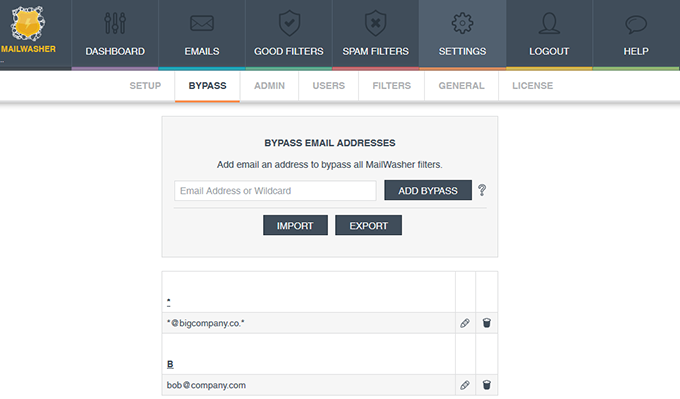

You can setup a whitelist which will allow any email address on the whitelist to bypass all the spam filters.
Note: You don’t need to add your email address or domain to the whitelist, as MWES will detect that you’re working from a local LAN. Spammers frequently use your own email address to bypass filters, so leave your company email addresses off the whitelist.
Note: You can also use wildcards * and ?
? will match any one character and * will match zero or more unknown characters.
E.g. w?lly@hotmail.* will match: willy@hotmail.com, wally@hotmail.co.uk and wally@hotmail.com
whitelist
The IP Whitelist is automatically populated by the greylisting feature when an email is rescued. In this case the domain and IP address is added so those emails are let through automatically next time. Alternatively you can add your own. IP ranges can be expressed in CIDR notation.
ip whitelist
You can setup a custom filter for good email, so for example, email matched against a particular subject line will bypass the spam filters.
Filters can be either plain text or regular expressions (regular expressions syntax from Regexlab)
When filtering multiple values:
To use OR operator, choose ‘Reg. expression’ and separate each filter value with a pipe e.g.
one|two|three|four
to use AND separate each filter value on a new line. e.g.
One
Two
Three
Four
custom filters

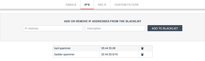

You can setup a blacklist which will stop any email with that blacklisted email address from passing to end users inboxes.
email blacklist
You can add IP addresses to the IP blacklist which will stop any email with that blacklisted IP address from passing to end users inboxes. IP ranges can be expressed in CIDR notation.
ip blacklist
RBL’s are used to block known sources of spam. MWES supports both URL and IP based lists.
rbls

Bayesian filters learn the difference between your good email and spam email and become very accurate after a brief period of training.
After enabling the Bayesian Filter (Settings >> Filters >> Settings) and setting the amount of email to train, incoming email is collected in the Bayesian screen (Settings >> Filters >> Bayesian Training). On this Bayesian Training screen, once you have the recommended number of email listed, you mark email as good (thumbs up) or spam (thumbs down). Ideally you want around 50% spam and 50% good email.
When you are ready to use the bayesian filters, click the CHANGE button to make the filters active. The incoming email collected to the Bayesian Training screen will stop and the bayesian filters will start classifying your incoming email.
  • Note 1 - You may wish to disable bounce/undeliverable notifications (Settings >> General) as some false positives are likely at the beginning of bayesian training.
  • Note 2 - Rescuing an email from Quarantine will add the email to the Bayesian Training screen as a good email and update the bayesian filters.
  • Note 3 - You may wish to enable Spam Reporting (Settings >> General) as any spam reported will update the bayesian filters. Spam Reporting appends a spam reporting link to all non-whitelisted incoming email.
  • Note 4 - You may wish to add legitimate email addresses to the whitelist to avoid the bayesian filter entirely. That way the bayesian filter will only need to be trained on outlying legitimate emails.
Recommended number of emails to train bayesian is
  • 40 - 100 for a site with a small amount of incoming email.
  • 100 - 200 for a medium sized site
  • 200 - 500 for a large site
bayesian filters
You can see the thumbs up (good) and thumbs down (spam) icons used to classify email for training.
training emails
Reporting spam by users is helpful in that it helps train the Bayesian Filters so they’re kept up to date.
Users’ incoming non-whitelisted email will contain a ‘Report Spam’ link which they can click to report an email as spam. This link will be either embeded in the body of the email, or as an attachment (Microsoft Outlook always converts it to an attachment).
Report Spam can be enabled in Settings >> General
report spam
Email addresses and domains can be added to bypass all MWES filtering and be delivered straight to the MTA.
bypass email

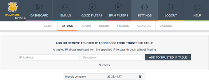

A trusted IP allows mail sent from the specified IP to pass through MWES without filtering.
trusted ips
After the 30 day free trial is finished, if you want to keep MWES you must purchase a user license appropriate for the number of users you have.
Once you have purchased the license you will be sent a 12 digit license key. Enter these details in to the Settings >> Product License screen to continue using MWES.
license
The Admin Details screen is used for the administrator to change their username and password to access the software.
admin details
